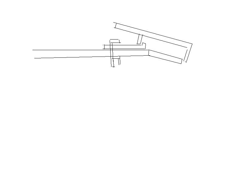

Yes...the article that Dwayne Waterman wrote way back then has the best looking picture of a way to clamp it. He cut a block that has the opposite corresponding angle to the angle of the head so that you first clamp that block to the neck and a clamp straight from the end of the head to the angled back of the block he cut.
I dont have a way to scan the drawing of the clamp setup but here is a REALLY crude drawing to illustrate the clamp block he used
